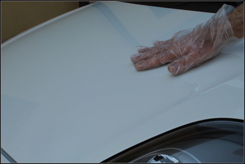

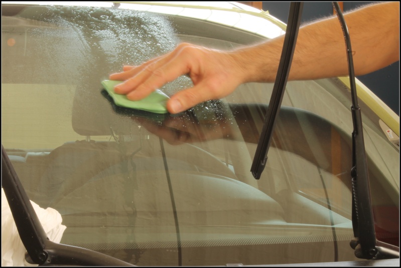

SITUAZIONE DI PARTENZA
PREWASH
WASHING
TAR REMOVER
IRON REMOVER
CLAYING
INSPECTION
POLISHING
BEFORE/AFTER
50/50
FINAL RESULT
