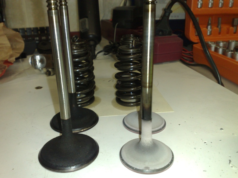

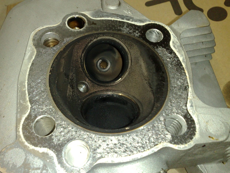

ecco come si presenta la parte termica:
![BUELL UPGRADE 2011 19012010](https://i.servimg.com/u/f67/14/07/58/06/19012010.jpg)
![BUELL UPGRADE 2011 19012011](https://i.servimg.com/u/f67/14/07/58/06/19012011.jpg)
![BUELL UPGRADE 2011 19012012](https://i.servimg.com/u/f67/14/07/58/06/19012012.jpg)
